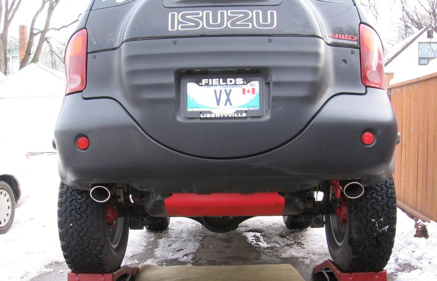

New Morgan-tec SS muffler (polished). This muffler is a work of art and built like a tank. The guys at the shop were quite impressed (thanks again Mike!)
2.25" inlet and 2x 2.5" outlets. No extra baffling.
It's tied-in right after the stock "Y" from the cats. I'm thinking of replacing the cats and re-do the piping and O2 sensors later.
Sorry I didn't get "before" pictures.
Re-used existing rubber mounts.

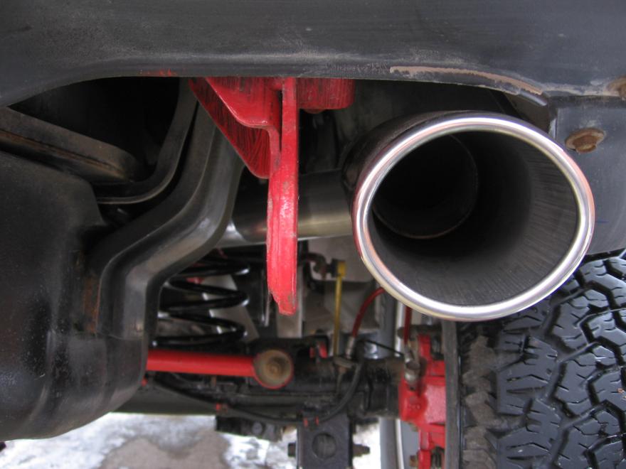

NEW DUALS!![]()
and new tips- 2.5" - 3.25" - Single walled, rolled edge, oval.

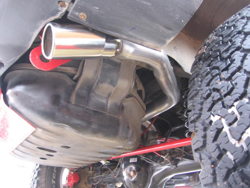

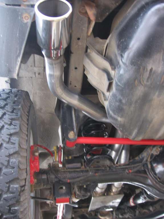

Up and over and around the gas tank. The 912 lift gave oodles of room.
one piece:
two piece:

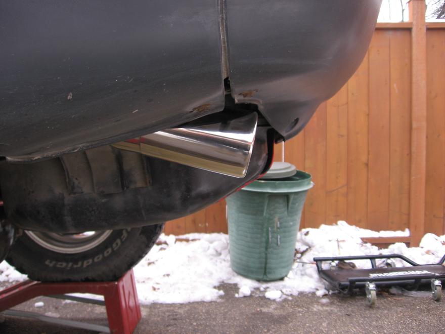

I had them place the tips recessed so they would be less prone to dissapearing on moab trails (a la Tone)
Unfortunately, to get the look, I lost the ability to use my shackle.
